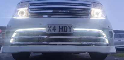

I unbolted the wing a bit to give myself room to slide the led into place. The LEDs were in a rectangular plastic sleeve that you have to stick onto the top of the light. The light has a rubber gasket that protects the edge of the wing... I gently eased that off and tucked it inside the end of the wing before sticking down the led strip.I've been tinkering with installing similar on mine and found that the bonnet sits below the side of the light how'd you get yours so straight? mine have a kind of kink in them at the edge of the bonnet also i think yours must be a bit more expensive as they look less like a line of leds and more like a smooth strip as they light up. Any tips and tricks you can share @Winchester ?
2x Sequential LED Strip Turn Signal Switchback Indicator Daytime Running Lights | eBay
2x 30/45/60cm Super Slim Strip Tape Lights (length depends on your choice). White and amber flexible soft LED Strip Light for car. When switched to yellow colour, it can be used as turn signal light (Flowing Water Model Light).www.ebay.co.uk
These are the ones I got, and they slid in under the wing. but beneath the wing the headlight steps up an then down where the bonnet is and its tricky to get it looking decent. I may have to get some different ones or mess about with the fitting a bit more. Looks okayish but not nearly the effect I was looking for.
Remember there is a bright side to these .. so after wiring check as you may have to flip them over ..hope these photos help View attachment 29325View attachment 29326View attachment 29327View attachment 29325View attachment 29326View attachment 29327

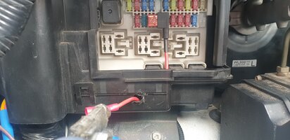

Would you know where the fuse is for the side lights? Thanks.Check fuses.

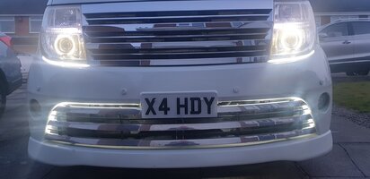

I like the factory look of these. Good job. How did you feed in the led? Did you have to open up the headlight assembly? If so how easy was it and have you managed to get a decent seal afterwards? CheersThese are mine:
Quite a challenge separating the lights to put them in! They are a lot brighter than they look in the picture. They have the flowing indicators too:
I repurposed the old indicators as sidelights instead.
Your wife will kill you and whilst you are at it use the parts washer as well aka the dishwasher....Haha. Thank you very much for the info. Nothing is ever as straightforward as we hope it will be! You've inspired me to give it a go though! I've seen some clips of people opening the assembly (on other models) by sticking them in a low oven for 7 mins ! What's the worst that could happen![]()
