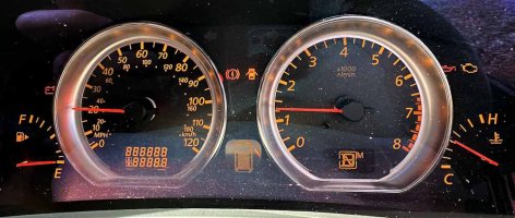

Next job will be to fix the needle position, both speedo and rpm gauges are wrong.
(clocks in maintenance mode)

Both overread, when the ignition is switched on (engine still off) the gauges jump up rather than staying at zero. The speedo jumps to 10mph and the rpm gauge to about 750rpm, so they both overread by those amounts.
They should look like this in maintenance mode:
Thanks for sharing @softin 's instrument service mode post. I have a problem with my fuel gauge not showing correctly. I'll try this tomorrow.👍

First success of the day, corrected my fuel gauge using info from posts by @Monkfish and @softin, to get the instrument cluster into maintenance mode. As I suspected, there was an issue with the needle. When I filled up the tank, it would only register 3/4. Gained 1/4 of a tank of fuel - Bargain!
