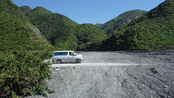

Your E50 is an inspiration to me. Now I want raised suspension on my wagon too. The rules and regulations in NZ make it hard to do, but there is always a way.
In case the Russians are disconnected from the Internet, rest assured you are in our thoughts and we all hope normality returns soon.
In the meantime, just remember that in New Zealand there is a sad little E50 wanting the Siberian Tractor setup.
