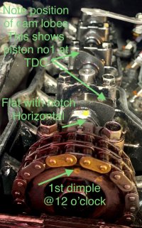

Feature of 4M40)))QD32 does not have a chain or belt, just gears + no dampers, everything is as simple as possible)Your photos are like a scientific dissertation))))The most reliable way is to remove the valve covers and look at the valve lifter cams))You are now more than half way down the Rabbit Hole.
I could not use the marks from the bottom pulley wheel against the marks on the casing to determine number 1 at TDC as the pulley wheel is known to slip on the harmonic deadener, so the marks were unreliable.
I had to go down the long route to time it up changing the chain whilst i was there.
With the 4M40 pump being mechanical any deviation from the bible means - do it again.![]()
