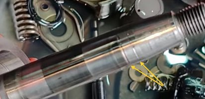

What amazed me when i rebuilt the pump was the pump main shaft had a groove worn into it ( not deep but you feel it ) this was from the front seal, the front seal is rubber and the shaft is tool steel, how the hell does that happen ?

diesel engines from the 80s and 90s .. then there were only 2 manufacturers Zexel and Bosch. all pumps are almost the same... such grooves are a common occurrence. It happens, you shouldn’t forget how old the car is) nothing lasts forever...
