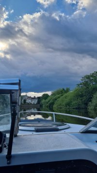

We slowed down to put the weather cover on fully just after the A64 bridge, dark clouds above, glad we did because it peed it down when we got to York a few minutes later.
Going slow on approach to the bishop's house, boars moored just behind us.
