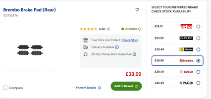

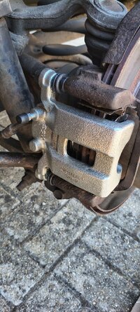

What pads are available from ECP? Is there a different model that's the same?One side done...JDM callipers arrived today, along with some slider pins from eBay. Brembo pads from ECP. new slider pins head was just too big to go behind sway bar thing on the lower location, but old ones in good nick so cleaned and reused with rubbers from new kit. Visual check of other 3 wheels shows fronts are good, and other rear is low but not as bad, suspect calliper piston was sticky, noted rubber was perishing around it, so fingers crossed the battlebus will be back in action soon...
I meant for what car are they listed for? Tend to steer clear of them because they think I have a 350z according to the computerI got Brembos from them. As far as I know rear brakes same all years E51
Ecp identified mine as an E51, but I'll get the ecp part nos in a bit..I meant for what car are they listed for? Tend to steer clear of them because they think I have a 350z according to the computer
Thanks, no rush as I'm not in need currently but might be worth posting in the E51 tech part for other users to accessEcp identified mine as an E51, but I'll get the ecp part nos in a bit..
