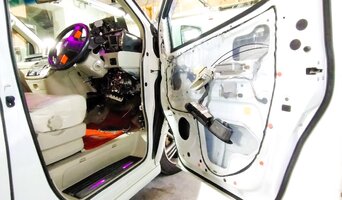

I'm doing a few little mods and improvements to previously fitted gizmos, repairing some broken plastic bits and I have a pair of JBL speakers that have been on my shelf for yonks also. As it's so hot out I thought to take the opportunity to stay in my cool garage and do something useful.
Also doing some interior decorating. Did you colour the upper bits of your door cards or just exchange them for black ones?
Oh yeah , forgot to ask , “ what you doing mate “ lol
Trim clips stayed put when I pulled the card off as I slid it back off the clips.
Exchanged the tops of my door cards as I found black ones online cheap enough plus they had chrome trims to match the door openers ( they are attached with plastic welds/rivets and can be removed easy enough as long as you’re careful).
