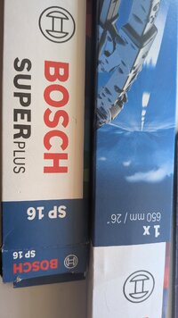

Fitted wipers. The aero/ frameless wipers that worked fine and are not very old suddenly stopped wiping where my eyes line up to. Put framed ones on, perfect wiping again. I have seen mention of bending arms. Arms seemed fine, spring seemed fine, old blade looks fine. No idea what the cause was!16016.jpg
