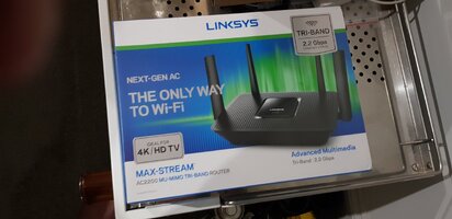

Picture of the Linksys EA8300 that I have

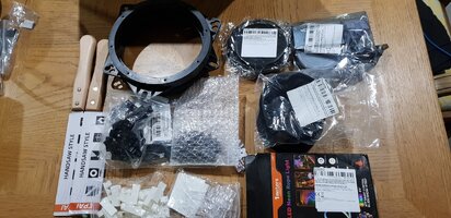

Also a few more bits from Aliexpress have turned up
In with these bits are a pair of 6.5 universal spacers for the front doors which look to be a perfect fit for the mounting holes on the Elgrand and at about £3 for the pair are considerably less than the specific spacer covers sold for the Elgrand in the UK which seem to about £20 up
Also bought from the same seller a pair of speaker extensions for about £2 as I am thinking I may cut out the Elgrand speaker grill and mount the speakers on top of the existing grill with it's own covers that they came with if I can make it work as I like that this would then allow the orange cone on the bassface to show through and would match the SPLX subwoofer in the tailgate zone.
Included in with this delivery are a couple of Ryoba pull cut saws as a few of the cuts to the units will need to be done in situ rather then dismantle the whole conversion and I remember from when we installed the units in the first place even with a router we had to go really careful or the veneer would crack and splinter
Will most likely undercut very slightly and finish of with a hand sandpaper as even though it will take a bit longer is preferable to having to recut a whole panel and even though I have over half a sheet left plus some decent size offcuts would prefer this rather than chancing running out as if I had to buy more it was £160 per sheet plus delivery when I bought it 7 years ago so likely more now
Also included in with these are a new pair of foam ear pads for my Grado500 pros
