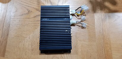

A used made in Japan Alpine3540 2 channel amp which dates from the early 1990's in unbelievable condition considering it is over 30 years old with just a couple of very minor marks on the casing. it is 35 watts RMS per channel and is very highly rated for its clean and detailed sound.
From what I have read it is quite a warm sounding amp so will use some chord rumour speaker cable which is silver plated that I have in my stash of about 9 metres so hopefully will be enough to brighten it up a bit
A new pair of Bassface 6.5 inch GT- FR635 3 way coaxial speakers which are rated at 70 watts RMS per speaker so should match pretty good with the Alpine amp, these have Neodymium tweeters which again would probably be quite bight so should also work well with the Alpine amp and the Chord Rumour cable
Although the Alpine amp might seem a bit underpowered for these speakers I have read that they typically output more than there rated wattage and as the Bassface have quite a high sensitivity of 90db hopefully they will be a good match and plenty loud enough especially if zone 1 is combined with zone 2

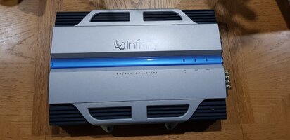

A used Infinity Reference 7541a 4 channel Amp which dates from around 2005 which again is in unbelievable condition considering its age with just a couple of very light scuffs.
This amp has a rated output of 111 watts RMS per channel although from what I have read real world output is more like 120 or 130 watts RMS per channel. Reviews that I have read indicate it has deep bass and a detailed clear powerful sound

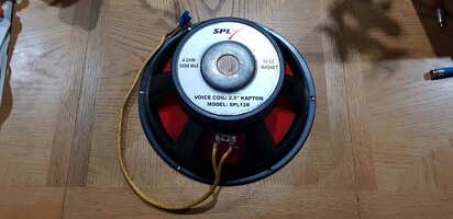

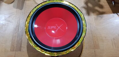

A used SPLX 12 inch sub in its own sealed enclosure, whilst the enclosure is in good shape it needs a bit of tidying up and I have bought a grill for it to protect the woofer and will also add a bit of polyfill in the enclosure.and will also upgrade the wiring inside the enclosure to the woofer with some cable I have in my stash which although I am not certain what gauge it is looks quite a bit thicker than what is in it at present and it will do no harm to properly solder it in as at present the existing wire is only wrapped around the woofer terminals.
This is rated at 500 watts RMS and has a 50 oz magnet.

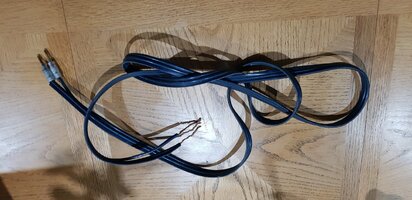

Will be using a Chord Odyssey 4 speaker cable speaker cable from the crossovers to both the mid and tweeters on the Blackface as I have a short length of about 30 inches that is spare in my hi-fi stash that at one time I was using to connect to a Linn active centre speaker but have since upgraded and due to the shortness of the length am unlikely to use it elsewhere else so might as well get some use out of it and would be ideal for this.
This is 12 awg cable and will use 2 strands for each crossover making it 9awg
Same as the Chord Rumour this is silver plated cable and as the Shoc from the reviews I have read is quite a warm sounding amp similar to the Alpine with a lot of bass thump this cable should balance it out a bit.
Total cost of this zone not including the Chord Odyssey 4 speaker cable cable £290
I have bought 30.5 metres of Amazon14 awg OFC speaker cable which is far better than the CCA cable which is normal for this price point and will be using this for all the other speaker runs.
Cost of this cable was I thought a good buy at £20
Will be double running this 14awg cable for the subs and maybe for the Bassface BlackfaceSPL5C.1 to the crossovers and to the Boschman 6x9's as well if I have enough but will only run to Boschman as a single run as will be to thick to get in the doors as a double and not really needed as these speakers are not so powerful as the others so will st the gain down a bit on these.
This will effectively make the gauge11awg on these doubled up runs.

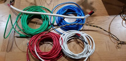

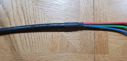

From among my stash of hi-fi bits i have stripped back a 15 metre length of Canare made in Japan video cable that was originally made by Mark Grant that at one time I was using with a quite high end Mitsubishi HC5000 Projector which I bought used to watch the 2016 Euros which is long gone. This is very good quality studio grade cable but with the advent of HDMI is now obsolete but is perfect for sending signals.
This will be used to connect to a Getue PRV Audio DSP 2.8X Cross over and Equalizer 8 Channel Processor which I have still to buy which will be fitted in the centre consul between the front seats along with the sub controller for the 8 inch Vibe Slick so that I can control and turn on or off and change f required the settings on all 3 zones or the sub either from the driving or living zone.
The cost of the DPS s £80.

Also in this cupboard will be the Infinity amp which I am intending to mount vertically as I think it is just to nice a looking amp to hide away and so will try to make feature of it by offsetting it off the cupboard panel slightly with a neon rope around it.

I do have a number of decent quality RCA cables in my stash which I could use but they are mainly in shorter 1 and 2 metre lengths so may buy some more cable to make custom lengths as required.
The Alpine amp in the driving zone will be running off my Yuasa YBX5334 starter battery with all the other amps running from my Yuasa l31-EFB leisure battery

I have some18mm ply left from the camper build and will be making custom sealed enclosures for all 6 of the speakers and the Vibe Slick sub in the camper units filled with polyfill and also adding a few more brackets to the camper units to make them more rigid.
Will also be adding some polyfill in the SPLX sub enclosure.
