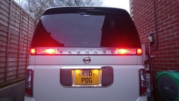

I think my favourite mod has been rewiring the rear lamp cluster so the inner brake lights are now fog lights and fitting a Nissan style switch to turn them on. Fairly simple and subtle but I like to keep things looking as though they might be original factory fitments.
Rewiring the lights was pretty straightforward and just involved cutting the existing feed and reconnecting it to the fog light wiring that had been used to convert the reversing lamp into a fog lamp (done by the importer). The hardest part was feeding the wire up through the rear body work and through the rubber cable channel into the back door. Another benefit of this is that the reverse light was returned to its original purpose making reversing at night easier.
dsc_1301-jpg.22104
I obtained the four slot switch back panel from Amayama and the switch itself from Ebay and it's a direct fit and just clips in. The back light is orange to match the others and it lights up green when switched on just as the front fog light indicator does on the dash. I wired this with a fused relay in circuit, taking the power feed from the fusebox which is behind the door below the switches. There are a couple of empty fuse slots so I tapped into one which was from a switched feed rather than permanent. So that's it really, nothing flash but looks original and like it came from Nissan that way.
