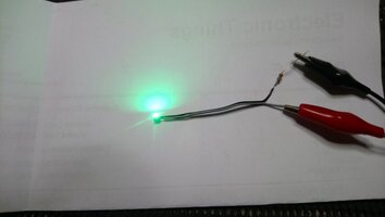

So I decided to light up the symbols from directly behind which involved removing a bit of paint from the diffuser to the rear of the N and D. The P and R have no paint. Then I wired up some SMD LED's to test the theory and these were a marked improvement when place directly on the diffuser.

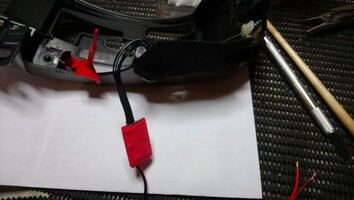

The pics below show how they are wired.

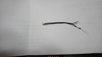

The next stage was to wire four LED's to a section of veroboard with the relevant bias resistors fitted. I shrink wrapped the board for protection.

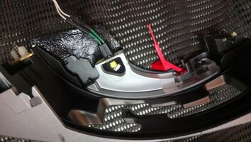

To fix the LED's in place on the diffuser I didn't want to use a glue of any type as this is rather experimental and some LED's have a habit of failing fairly quickly, so I came up with the idea of using a length of very sticky insulation strip which happened to be the exact width I needed, and I carefully laid them up in position.

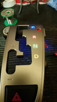

Then a final test before refitting.

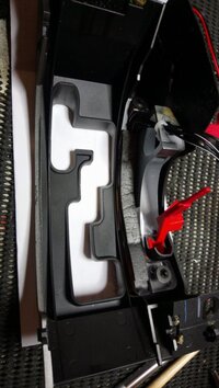

It was then just a matter of fitting a couple of bullet connectors to the wiring and putting it all back together.
Hopefully the LED's will not fail too quickly as it's a bit of a faff removing it all. Time will tell.
