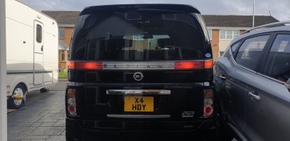

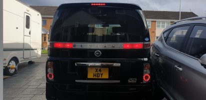

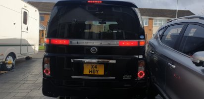

Looks really good. I have a question, after looking at you first photo, when you turn your lights on, do your lower lights come on as well as the upper ones?Added some brake lights to the centre bar I had in the garage.
Lights
Brake and lights
Brakes
Yes they do. It's a mod that I think @LeStempy came up with.Looks really good. I have a question, after looking at you first photo, when you turn your lights on, do your lower lights come on as well as the upper ones?
