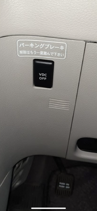

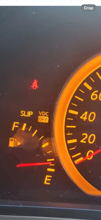

The VDC system ,if fitted, is on by default and will have a vdc switch , usually under the steering wheel so it can be turned off if you need to ( snow etc)—— no switch usually means no VDC.
Apparently it was fitted to certain 4x4 models and some high spec models, it was also one of those Elgrand things where if buying new you could include it or leave it out etc ;( only in Japan lol)
Just “ borrowed “ these pics from “elsewhere “.
One shows a VDC switch in an Elgrand the other shows the slip and VDC off warning lights as would be normal if manually switched off etc
My black one (that I mentioned above) has that switch.
