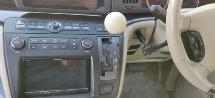

MASSIVE polished knob. 60mm [or 2 3/8"].
£13 off eBay, drilled a 12mm hole, tapped a piece of 12mm s/s tube to M10 x 1.25mm, Araldited it in....
Screwed the knob, good and proper.
£13 off eBay, drilled a 12mm hole, tapped a piece of 12mm s/s tube to M12 x 1.25mm, Araldited it in....
Screwed the knob, good and propper.
I'm confused - reading through this thread most people that mentioned the threads said they were M10, but yours is M12?
I have a 2006 E51 - can anyone please confirm the correct thread size?
Sorry, typo. Checked my notes, it is M10 x 1.25, I'll amend my original post 👍🏻

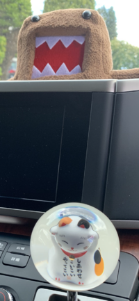

That's awesome, my daughter is obsessed with lucky cats and would love that. If I didn't already have my bamshift that's what I would have!
I thought it was maybe a bit cheesy, but for £13 why not?
