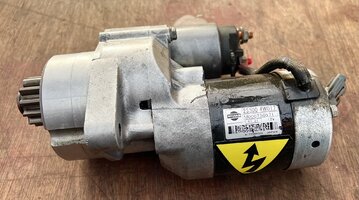

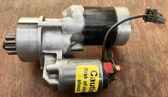

I rebuilt my old starter and found the two motor bearings to be fine, the brushes x4 were half worn and the contacts on the motor were black - I cleaned all contacts with wire wool.
I think the solenoid was the fault, as the plunger would not fire every time when hooked it to a battery.
After opening and cleaning the plunger and bore with wire wool then lubricating - It fired every time.
So I replaced the brush collar in the starter with a new one and cleaned everything and now I have a good genuine Nissan starter to put in my ‘just in case drawer’.

In several places the internal parts were stamped MITSUBISHI as is the id sticker - a bit odd.

Great pics - really helpful. 👍
Don't suppose there's a manufacturer / part ref on the solenoid unit itself?
Any pointers for where to get hold of the brush collar for the motor would be very much appreciated.

Sorry no, can’t remember - I’ve only got those photos of the brush ring nothing else.
