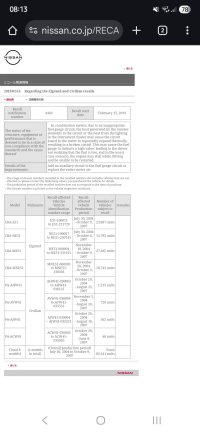

Hi all I don't think the recall part worked or it's my fuel sender because it doesn't drop below quarter of tank and it run out of fuel today luckily in my garden

You could just take the cluster out to check the recall has been done it's an easy job to do but do make sure you disconnect the battery first

I would, with the tank empty, remove the instrument cluster and set the needle to ‘E’. Then fill up the tank and see if it shows full. I’m not sure if they check the needle position after installing the mod.
There's a specific set up procedure for needle position setting. It's on here somewhere. Not near a computer at the moment though.
Yes, I forgot about that, I did it myself some time ago
