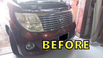

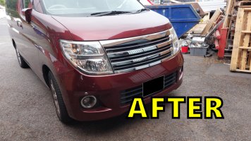

So I bought myself a rider grill to go on my X non rider E51 because I quite like the look of the de-badged grill with thicker bars. The fitting locations looked the same in the photo's, but they are completely different!

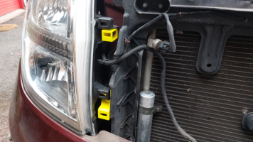

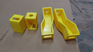

SO anyway I didn't let that stop me! The grill physically would go into place but there is just a big gap between the mating surfaces of the brackets so I measured it up and disigned/3d printed some brackets. Took 3 attempts to get them the right size. Looks really nice I think. Also got some better condition headlights so the front looks brand new now! Link to the 3d print files if any one wants them- https://makerworld.com/en/models/1577739-Nissan-Elgrand-e51-brackets-to-fit-rider-grill#profi
The brackets fit using the headlight bolts
