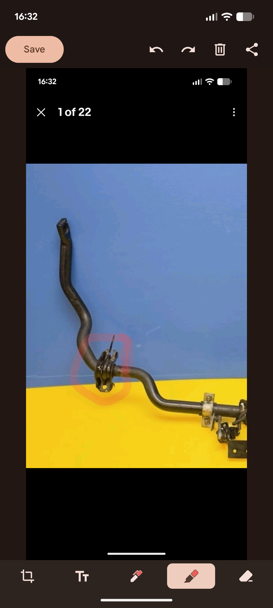

But, on a few windy days, I found the cross winds, especially on motorways, were very challenging, I put poly D bushes on the front sway bar, found this helped, so I put them in the rear, D bushes, the rubbers in the rear had disintegrated, the difference on a windy day was night and day
I believe there are 3 different sizes so if you decide to replace, please measure first, as said what you put on your motor is your business
The thing with suspension is it's not just about springs. If you only change the springs for HD items the original dampers, which will already be worn, will have extra work and not be sat in their intended operation range. If you really want to improve thing it's necessary to consider the suspension as a whole including ARB's, shocks and springs, otherwise you will just end up with an imbalance.
When i replaced the rear springs I did the shocks as well but as yet not touched ARBs drop links etc. The handling is okay on motorways in crosswinds it just seems to roll a little more on corners, maybe due to the slight increase in height. I'm not after sports handling just a nice but secure ride, I thought polly bushes made the ride harsher but it probably would benefit from new rubbers, they are probably the originals. Are polly D bushes different to normal polly bushes?
I agree poly makes the ride harsh, but different colours give different results, think black is the softest ( could be wrong)
Not that I have any, apart from d bushes on the sway bars.
The d bushes are for the sway bar ( anti roll bar)
Do nothing to the bounce, just stiffens the SWAY on the sway bar ( roll bar whatever you call it)
If rubber no grease, you clean, so hopefully the rubber sticks to the bar through time giving a twist grip!!! So it losses strength through time.
Poly, you grease, allowing the bar to turn/ twist, but the poly doesn't move ( depends on colour), so it should give better strength

I agree with your take, what threw me was your second line "All the bushes in mine are standard, rubber.) I assume you meant "were" standard rubber. I do get the occasional "clunk" on rough (potholed) roads at the nearside rear, I looked at the droplinks and bushes and they seemed tight enough but it looks like I probably need new bushes, I'll look into the softer polly bushes, I thought they were all the same just different colours due to manufacturers. is the ride a lot harsher?, quite a few of the forum members seem to change them back to rubber if their Elgrand had polly bushes on when they bought it.

I decided to try poly on the sway bar ( d bush) only the sway bar d bushes.
because one time I got blown across the lanes on an extremely windy day.
I wish I did it sooner, but far the best thing I have done.
Edited, d bushes on the sway bar does nothing to the ride, it helps the sway.
I have no other experience with Polly on an Elgrand other than han the d bushes on the sway bars
